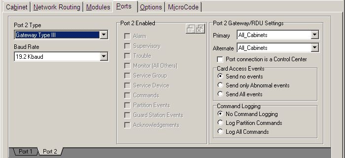

Hi,
The first check that yours computer COM port settings is compatible to the EST port settings.
The second I am highly recommend change COM port settings to the "Gateway Type III / 19.2K" and verify that yours user have relevant permissions. (see attached my EST port configuration
