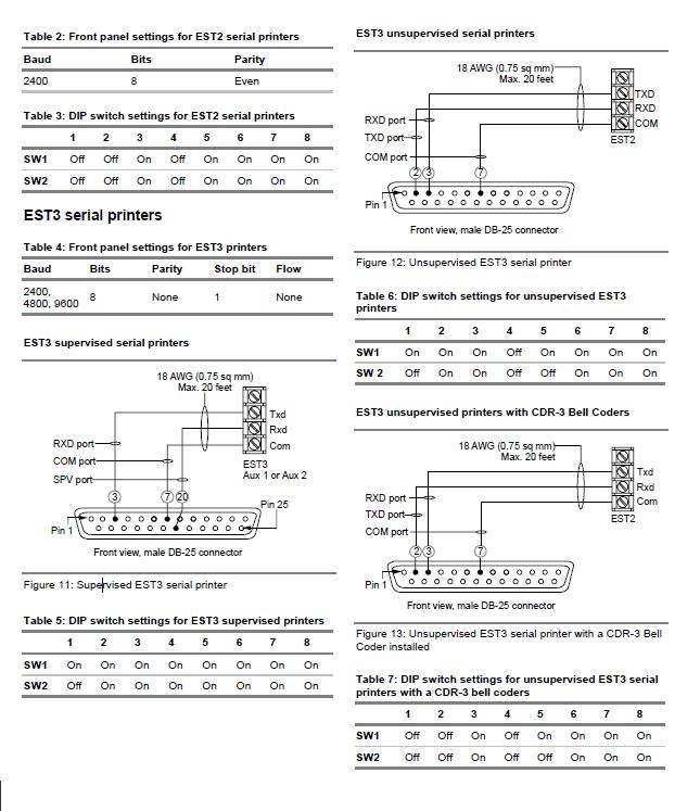

Dear Friends,
Can you give me the schematic of this connection from Epson printer that has 25 pins .
As you know we can just connect Tx, Rx and Com in EST3.
Best Regards.
Best Regards.
Re: EST-3 PRINTER
For example 9 and 25 pin
- Attachments
- Документ Microsoft Word (9).doc
- (49 KiB) Downloaded 708 times
Re: EST-3 PRINTER
Dear lts-maroc,
note the attachement.
hope this works with you
